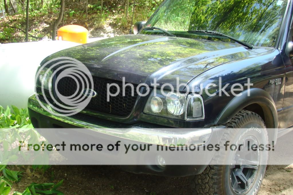

They look awesome IMO, if you guys want a write up just ask, i got mine from another ranger forum! Essentially you bake your headlights, seperate the lense, tape em up and paint away. thake a look tell me what you think!
OLDDD
NEW
[img]http://i526.photobucket.com/albums/cc346/zzack92/Truck001.jpg
179 Posts
Baisically, you take them out, pull your bulbs and put each light in the oven at 200 degrees and every 5-8 minutes pull it out and slowly work you way around the edges with a flat head and keep doing it, be wary it is a slowwww process but you dont want to crack your lights! after that you tape off your light bowls and then paint everything else! after, fill the crevis where the old glue was with new glue or selant/silicone.
