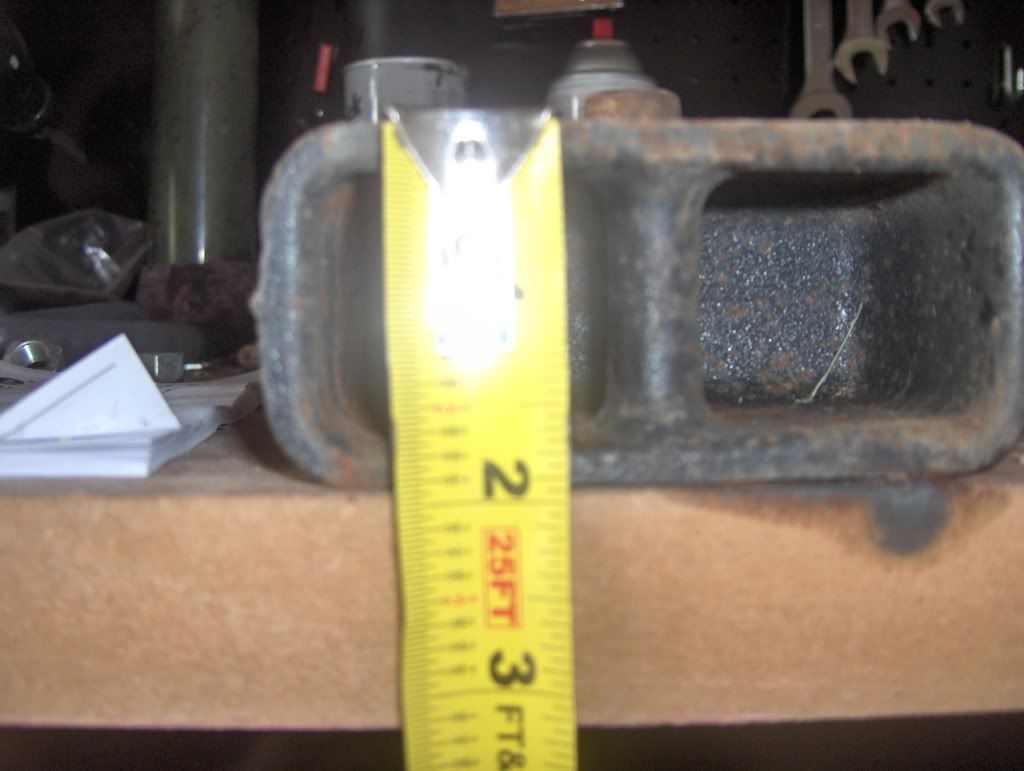

You should also remove the stock block in there rear that will lower the back down also. Stock edge blocks are 2" tall. If you removed them you would need new U bolts also

Yeah, I figured if I lower the front with the t-bar some and take the 2 inch blocks out of the rear then ill pretty much be at a decent height. That will probably actually give me the height I am wanting. Do you think so?

I would do the rear first with removing the block and then see how much u want the front.

It does make sense... the shorter bolt shouldnt be too hard to get would it? Ive never messed with my t-bars so im kinda not sure. So for the rear i would need new U bolts which I could probably get from a normal ranger at a junk yard and the drop shackles would be for more drop?
ok hold on a min. yes the chevy shackles lower a chevy and lift a ranger but you cant use them to lower a ranger. to lower a ranger cheap you would first pull the lift block for about 2". if you want more than that in the rear you would flip the rear hanger it should be like six rivets and two bolts to pull the hangers and you need to buy new bolts to put them hangers back on. the old u bolts should still work. for the front im sorry but i have not lowered a t bar front end. when i had my 96 xplore with the t bars i just cranked it all the way down
