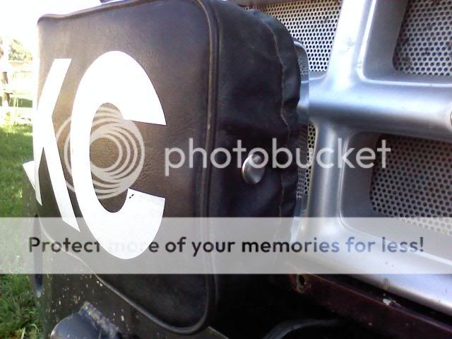

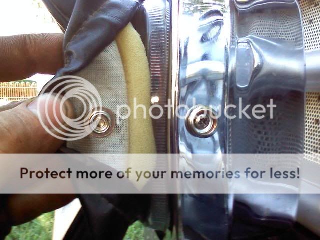

I don't know if this is a common problem or not, but I have a set of 6x9's and the Vinyl covers that are supposed to have an elastic band to hold them on won't stay on. So I went to Lowes and and bought some rivet on snaps. I put one half on the screw on the side of the light and I riveted the other half through the cover. I know this was a simple fix, but I figured I would share it with everyone on here anyway.
I spend a lot of time on the freeway to and from school and I am always worried a little rock will hit and crack the glass lense, so I like to run the covers on freeway (cant turn them on anway).
