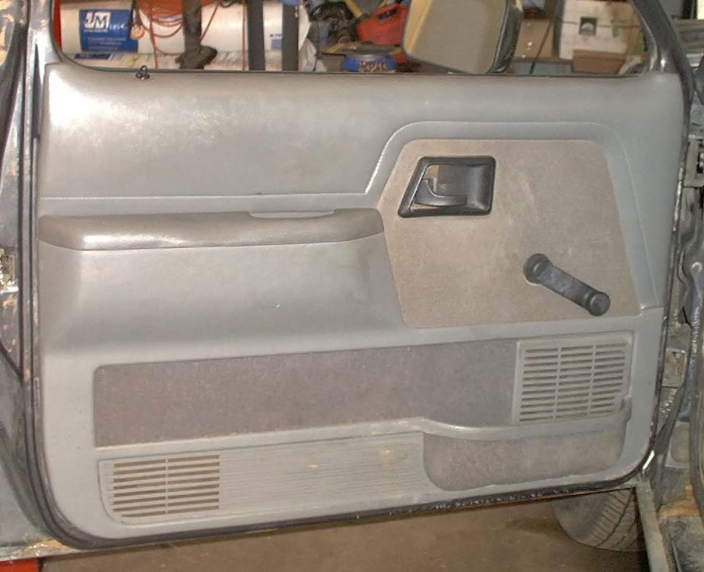

1. remove old door panel
2. remove inside window molding (the new door panel has it built in)
3. remove all the retaning clips from the new door panel
4. cut the aliment pine of of the new door panel with a hack saw

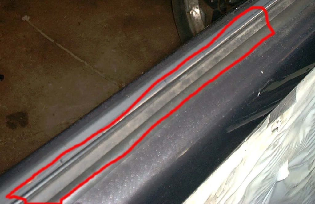

5. place tape over the holes in the arm rest support bracket
6. mount the bracket to the new door panel
7. fill the tape covered holes with the chalk dust
[img]http://i892.photobucket.com/albums/ac127/88DANGERRanger/88%20Ex%20Cab%20build/Untitled-9.jpg
8. hang the new door panel and tap the side of the arm rest
9. remove the new door panel the revel where to mount the support bracket
10. drill the holes withe the 1/8 drill bit

13. reinstall the door panel
14. drill 2 1/8 in. holes in the proper locations under the door pockets and screw it in
