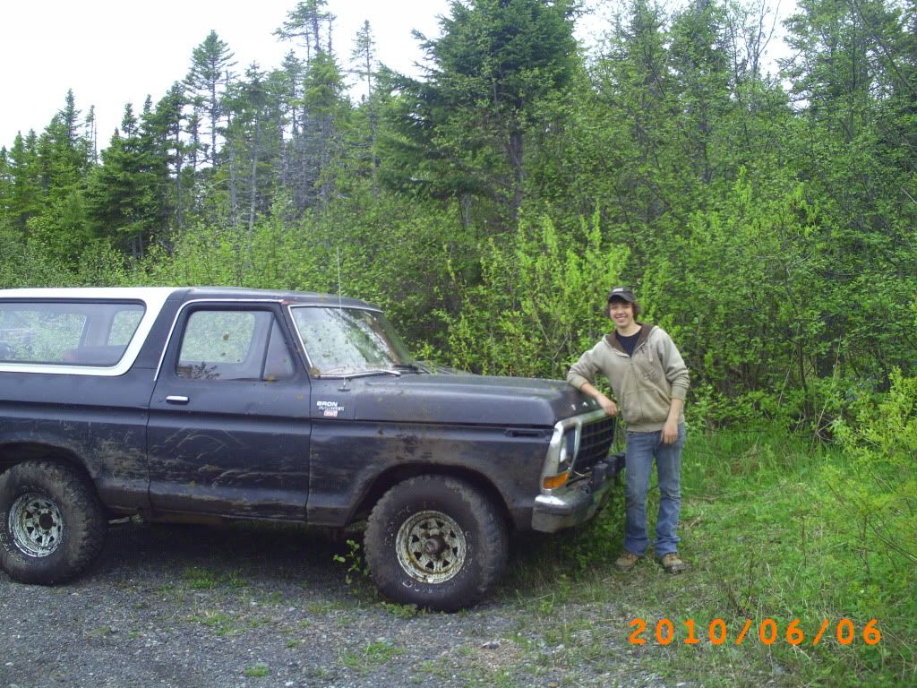

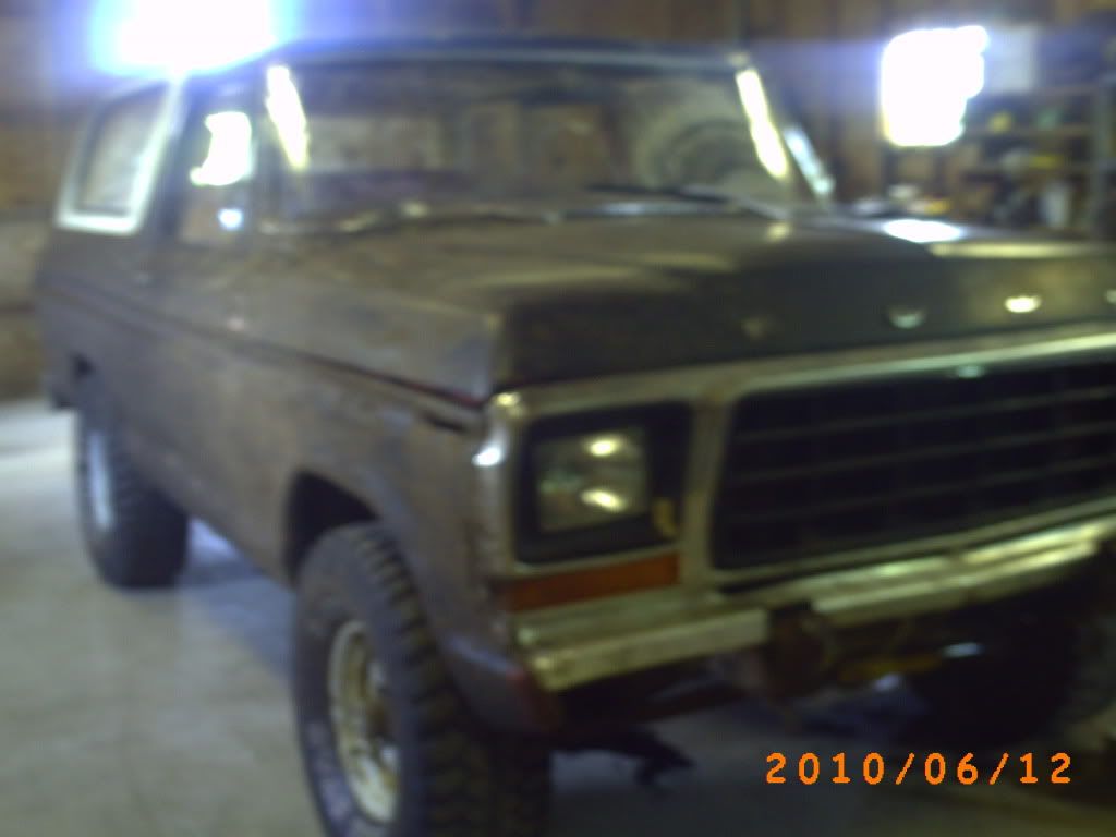

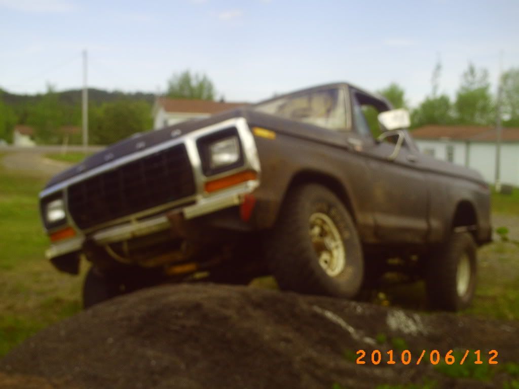

first thing i done was remove what was left of the chrome trim. then i cleaned out the interior and cleaned the carb but the carb still isnt very good, it was supposedly sitting in sand for 10 years.
and i hooked up some lights on the front bumper with a light bar i made out of a roof rack of a broncoII
added some 33x12.5 mud terrain tires and a leveling kit, and painted her with Rocker Guard, and painted the headlight surrounds
